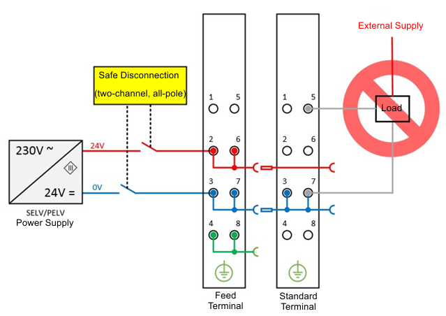

Feedback can be prevented through different measures. These are described below. In addition to mandatory requirements, there are also optional requirements – only one of these must be selected. - Do not switch loads with a separate power supply
Loads that have their own power supply may not be switched by standard terminals, since in this case feedback via the load cannot be ruled out. - A negative example here could be activating an STO input for a variable frequency drive.

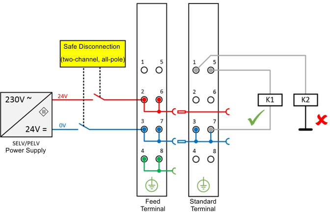

Exceptions to the general requirement are only permitted if the manufacturer of the connected load guarantees that feedback to the control input cannot occur. This can be achieved, for example, through compliance with load-specific standards. - Option 1: Ground return and all-pole disconnection
The ground connection for the connected load must be fed back to the safely switched ground. - If either
a) the load’s ground is not connected back to the terminal, or
b) the ground is not safely switched but permanently connected
, it is necessary to rule out faults related to short circuits with external potential in order to achieve Cat. 4 PLe in accordance with DIN EN ISO 13849-1:2007 or SIL 3 in accordance with IEC 61508:2010 (see the overview in the chapter “Effect of the options on the safety level”). - Option 2: Excluding cable short-circuiting faults

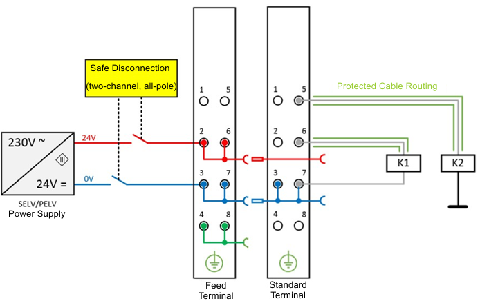

If option 1 is not feasible, the ground return and all-pole disconnection can be dispensed with if the danger of feedback due to a cable short-circuit can be excluded by other measures. These measures, which can be implemented as alternatives, are described in the following sections. - a) Option 1: Load connection using separate sheathed cables
The non-safely switched potential for the standard terminal may not be grouped inside the same sheathed cable as other potential-conducting lines. (Fault exclusion, see DIN EN ISO 13849-2:2013, Table D.4) - b) Option 2: Wiring is kept internal within the control cabinet
All loads connected to the non-safe standard terminals must be located in the same control cabinet as the terminals. The cables are routed entirely inside the control cabinet. (Fault exclusion, see DIN EN ISO 13849-2:2013, Table D.4) - c) Option 3: Dedicated earth connection per conductor
All conductors connected to the non-safe standard terminals are protected by their own earth connection. (Fault exclusion, see DIN EN ISO 13849-2:2013, Table D.4) - d) Option 4: Wiring permanently (fixed) installed and protected against external damage
All conductors connected to the non-safe standard terminals are permanently fixed in place and protected against external damage, for example, by a cable channel or conduit. - The options' effect on the safety level
