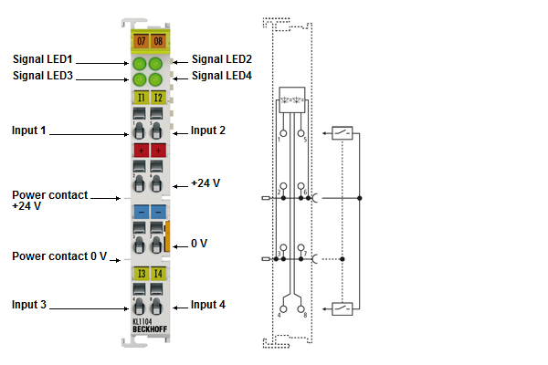

KL1104, KL1114 - LEDs and connection
Fig.9: KL1104 - LEDs and connectionKL1104, KL1114 - LEDs
LED  | Color  | Meaning  | |
Signal LEDs 1 - 4  | green  | off  | Signal voltage "0" (-3 V ... 5 V)  |
on  | Signal voltage "1" (15 V ... 30 V)  | ||
KL1104, KL1114 - Connection
Terminal point  | Description  | |
Name  | No.  | |
Input 1  | 1  | Input 1  |
+24 V  | 2  | Sensor supply +24 V (internally connected to terminal point 6 and positive power contact)  |
0 V  | 3  | Sensor supply 0 V (internally connected to terminal point 7 and negative power contact)  |
Input 3  | 4  | Input 3  |
Input 2  | 5  | Input 2  |
+24 V  | 6  | Sensor supply +24 V (internally connected to terminal point 2 and positive power contact)  |
0 V  | 7  | Sensor supply 0 V (internally connected to terminal point 3 and negative power contact)  |
Input 4  | 8  | Input 4  |
