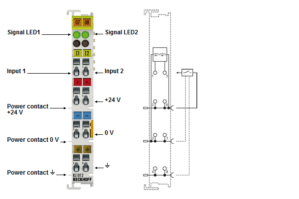

KL1002 - LEDs and connection
KL1002 - LEDs and connection 1:Fig.3: KL1002 - LEDs and connection
KL1002 - LEDs
LED
Color
Meaning
Signal LEDs 1 - 2
green
off
Signal voltage "0" (-3 V ... 5 V)
on
Signal voltage "1" (15 V ... 30 V)
KL1002 - Connection
Terminal point
No.
Input 1
1
Input 1
+24 V
2
Sensor power supply for input 1 (internally connected to terminal point 6 and positive power contact)
0 V
3
Ground for input 1 (internally connected to terminal point 7 and negative power contact)
4
⏚ (internally connected to terminal point 8)
Input 2
5
Input 2
+24 V
6
Sensor power supply for input 2 (internally connected to terminal point 2 and positive power contact)
0 V
7
Ground for input 2 (internally connected to terminal point 3 and negative power contact)
8
⏚ (internally connected to terminal point 4)
