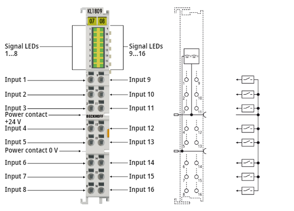

KL1809 - LEDs and connection
Fig.48: KL1809 - LEDs and connectionKL1809 - LEDs
LED | Color | Meaning | |
INPUT 1 - 16 | green | off | Signal voltage "0" (-3 V ... 5 V) |
on | Signal voltage "1" (11 V ... 30 V) | ||
KL1809 - Connection
Terminal point | Description | |
Name | No. | |
Input 1 | 1 | Input 1 |
Input 2 | 2 | Input 2 |
Input 3 | 3 | Input 3 |
Input 4 | 4 | Input 4 |
Input 5 | 5 | Input 5 |
Input 6 | 6 | Input 6 |
Input 7 | 7 | Input 7 |
Input 8 | 8 | Input 8 |
Input 9 | 9 | Input 9 |
Input 10 | 10 | Input 10 |
Input 11 | 11 | Input 11 |
Input 12 | 12 | Input 12 |
Input 13 | 13 | Input 13 |
Input 14 | 14 | Input 14 |
Input 15 | 15 | Input 15 |
Input 16 | 16 | Input 16 |
