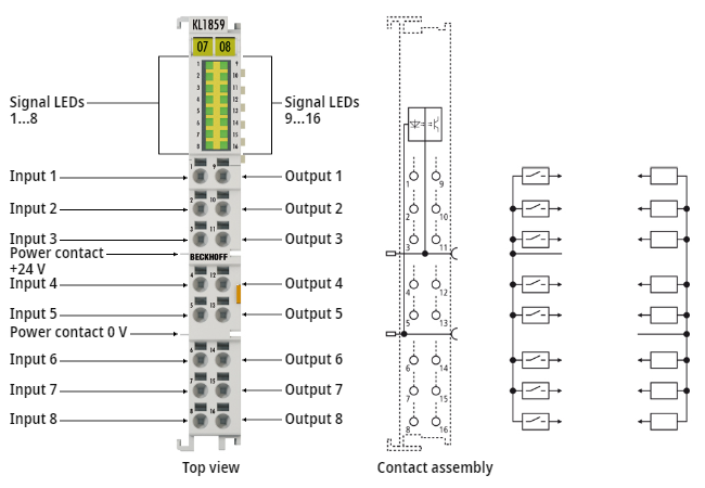

Bus terminal, 8-channel digital input + 8-channel digital output 24 VDC, 3 ms, 0.5 A
The KL1859 digital input terminal combines eight digital inputs and eight digital outputs in one device. The signal state of the channels is indicated by LEDs. The reference ground for all inputs is the 0 VDC power contact; the outputs are fed via the 24 V power contact.
