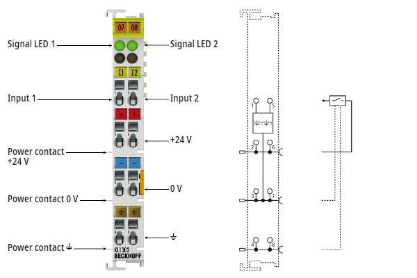

KL1302 - LEDs and connection
Fig.21: KL1302 - LEDs and connectionKL1302 - LEDs
LED | Color | Meaning | |
Signal LEDs 1 - 2 | green | off | Signal voltage "0" (-3 V ... 5 V) |
on | Signal voltage "1" (11 V ... 30 V) | ||
KL1302 - Connection
Terminal point | Description | |
Name | No. | |
Input 1 | 1 | Input 1 |
+24 V | 2 | Sensor power supply for input 1 (internally connected to terminal point 6 and positive power contact) |
0 V | 3 | Ground for input 1 (internally connected to terminal point 7 and negative power contact) |
⏚ | 4 | ⏚ (internally connected to terminal point 8) |
Input 2 | 5 | Input 2 |
+24 V | 6 | Sensor power supply for input 2 (internally connected to terminal point 2 and positive power contact) |
0 V | 7 | Ground for input 2 (internally connected to terminal point 3 and negative power contact) |
⏚ | 8 | ⏚ (internally connected to terminal point 4) |
