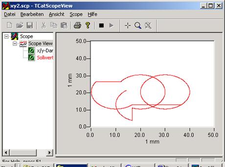

- Start manual blockG01 G90 X20 Y20 F100in the first channel
- SetSuspend-Outputin the first channel
- Start manual blockG91 Y10in the second channel and wait until end of its execution
- DeleteSuspend-Outputin the first channel
- SetSuspend-Outputin the second channel

- Start automatic program in the first channel
$WHILE 1
N10 G02 I10 F500
$ENDWHILE
- Set second channel into manual mode and move axes
