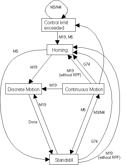

Spindle modes (not SERCOS)
Reference point travel without reversing 1:Fig.7: State graph of the spindle modes
