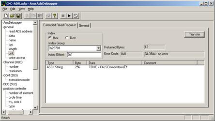

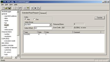

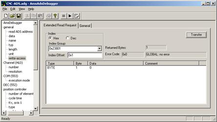

Programming exampleQuerying the attributesElement: Feedhold
IndexGroup = 0x20300 + <class = HLD> + <attribute> + <channel = 1>= 0x20300 + 0x3000 + <attribute> + 0x1 = 0x23301 + <attribute>0x23301, data content0x23401, name

Attributes 1:
0x23601, length

0x23701, unit
Attributes 3:
0x23801, write access
Attributes 4:
