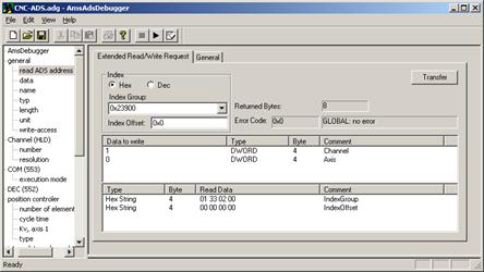

Programming exampleADS address query
IndexGroup = 0x23900 = 0x20300 + <class = HLD> + <address> 0x20300 + 0x3000 + 0x600
Input : Channel = 1, Axis = 0
Output : IndexGroup = 0x23301, IndexOffset = 0x0
