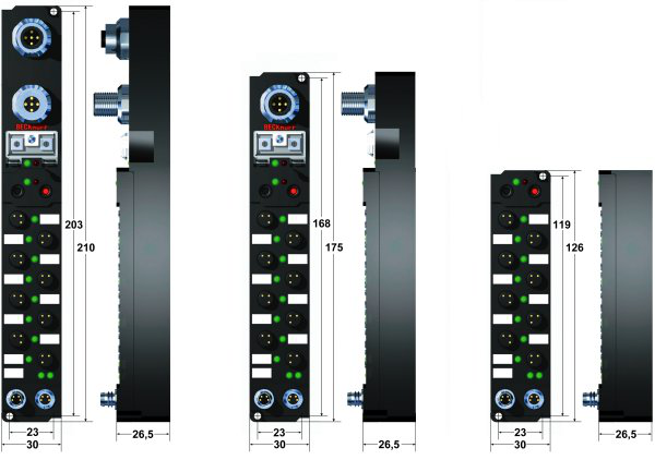

Dimensions
All dimensions are given in millimeters.
General
Technical data |
Fieldbus Box |
Material |
PA6 (polyamide), casting compound: polyurethane |
Assembly |
2 x fixing holes for M3 |
Metal parts |
Brass, nickel-plated |
Contacts |
CuZn, gold-plated |
Vibration / shock resistance |
according to EN 60068-2-6 / EN 60068-2-27, EN 60068-2-29 |
EMC resistance burst / ESD |
according to EN 61000-6-2 (EN 50082) / EN 61000-6-4 (EN 50081) |
Permissible ambient temperature during operation |
0 ... 55°C |
Permissible ambient temperature during storage |
-25 ... + 85°C |
Installation position |
any |
Type of protection |
IP65/66/67 when screwed together |
Approvals |
CE, UL E172151 |
IPxxxx-Bxx8, IL230x-Bxx8, IL230x-B110, IXxxxx-B400, IXxxxx-B90x, IXxxxx-C900
Technical data |
Compact and Coupler Box with integrated tee connector |
Dimensions (H x W x D) |
ca. 210 x 30 x 26,5 mm (height to upper edge of fieldbus socket: 30 mm) |
Weight |
ca. 260 g - 290 g, depending on module type |
IPxxxx-Bxx0, IL230x-Bxx0, IL230x-Cxx0
Technical data |
Compact and Coupler Box |
Approx. 175 x 30 x 26.5 mm (height to upper edge of fieldbus socket: 30 mm, with T- connector ZS1031-2600 height approx. 65 mm) |
Weight |
Approx. 250 g - 280 g, depending on module type |
IExxxx
Technical data |
Extension box |
Approx. 126 x 30 x 26.5 mm |
Weight |
Approx. 120 g - 200 g, depending on module type |
