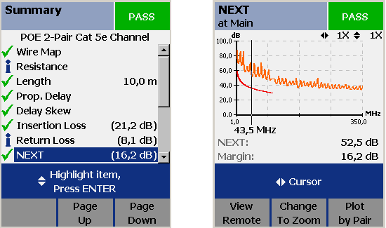

The following settings have proven to be standard-compliant and usable for the certification of a (possibly field-configured) Ethernet-EtherCAT cable section:
- Adaptor: channel adaptor DTX-CHA001A
Reason: unlike the patch cable adaptor, the screen continuity can be tested with the CHA001A. Since Nov 2008, according to Fluke, the connector compensation provided for in the channel measurement only takes place if the end plugs meet the electrical requirements for the performance class. Therefore, permanent link adaptors and double couplers need not be used. - Cable limit values: ‘POE 2 pair Cat5e Channel’
Reason: the cable limit values according to EN50173-1 Channel Class D and a 2-pair assignment are required. This combination is possible in the DTX1800 via this limit value record. The specified limit value record corresponds in its data in all relevant frequency ranges to ‘EN50173, Channel Class D’, but allows reduced cable assignment according to 1-2-3-6.
The limit value record (DTX limits) 1.34 from the Nov 2008 is used. - Cable
- for the Beckhoff ZB90x0 cables, a ‘user-defined’ cable must be created with
# 2 pairs/4 cores
# NVP = 62% (according to cable supplier’s data)
- if necessary, select a 4-pair/8-core cable from the manufacturer’s database - Connector Pin Assignment
- ‘Ethernet 2 pair’ (already defined in the database) or user-defined ‘TIA568B’ without contacts 4-5 and 7-8.
- or normal TIA568B pin assignment for fully assigned cable
