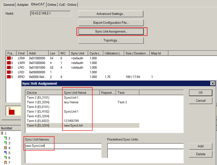

If an EtherCAT slave fails, e.g. an analog input box EP3174, this would mean other input data contained in the same datagram to make the frame structure efficient would also be discarded. As a remedy the user can manually assign each slave to a so-called SyncUnit. In extreme case each slave could have its own SyncUnit, with associated negative consequences for the fieldbus efficiency and excessive bus load.
The corresponding dialog is accessible via the EtherCAT tab, see Fig. TwinCAT view, frame structure - larger topology.
A slave is assigned to a SyncUnit, see Fig. Entering the SyncUnits in a default frame structure
If a name is allocated more than once, the slaves are operated accordingly in a datagram (logical SyncUnit).
Setting up - SyncUnits setup 6:Fig.244: Entering the SyncUnits in a default frame structure
This results in a new structure of the cyclic Ethernet frame in accordance with Fig. New frame structure with SyncUnits:
Setting up - SyncUnits setup 7:Fig.245: New frame structure with SyncUnits
The System Manager will continue to automatically consolidate devices that are not set manually in datagrams and may identify them as <default>.
