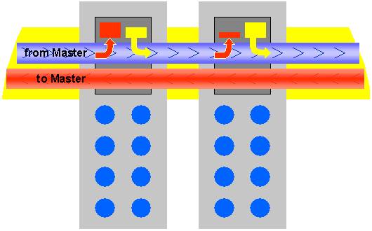

EtherCAT technology overcomes these fundamental limitations of other Ethernet approaches: the Ethernet packet is no longer received, then interpreted and copied as process data at every connection. The newly developed FMMU (fieldbus memory management unit) in each I/O terminal reads the data addressed to it, whilst the telegram continues through the device. Input data is also inserted into the telegram as it passes through. The telegrams are only delayed by a few nanoseconds.
New approach 1:Fig.22: Telegram processing as it passes through
Since an Ethernet frame reaches the data of many devices both in send and receive direction, the usable data rate increases to approx. 80 %. The full-duplex features of 100BaseTx are fully utilized, so that effective data rates of > 100 Mbit/s (up to 80 % of 2 x 100 Mbit/s) can be achieved.

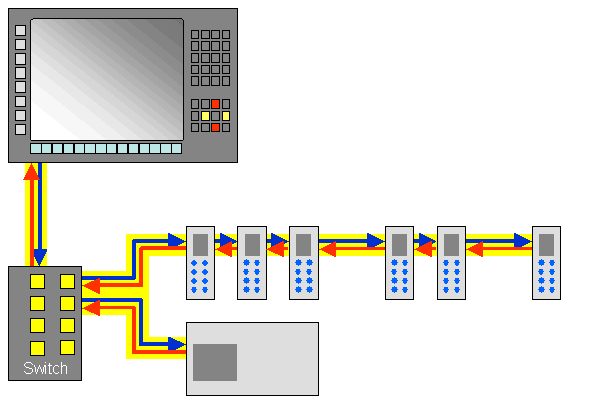

The Ethernet protocol according to IEEE 802.3 remains intact right up to the individual terminals; no sub-bus is required. Only the physical layer is converted in the coupler from twisted pair or optical fiber physics to E-bus, in order to meet the requirements of the electronic terminal block.
New approach 2:Fig.23: Full-duplex Ethernet in the ring – one frame for many devices
The EtherCAT system architecture increases the communication efficiency.

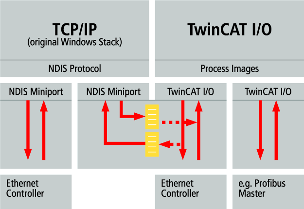

On the control side, the TwinCAT Y driver for Ethernet complements the FMMU technology. This integrates transparently into the system, so that it appears as an operating system-compatible network driver, and additionally as a TwinCAT fieldbus card. On the transmitting end, internal prioritization and buffers ensure that Ethernet frames from the real-time system always find a free transmission line when it is their turn. The operating system's Ethernet frames are sent subsequently in the gaps, provided there is sufficient time.
At the receiving end, all the Ethernet frames received are examined by the TwinCAT I/O system, and those with real-time relevance are filtered out. All other frames are passed on to the operating system after examination, outside the real-time context.
New approach 3:Fig.24: Operating system-compatible TwinCAT Y driver:
Very inexpensive, commercially available standard network interface cards (NIC) are used as hardware in the controller. The data transmission to the PC takes place via DMA (direct memory access). Therefore, no CPU performance is lost for network access.
Since the Ethernet functionality of the operating system is fully maintained, all operating system-compatible protocols can be operated in parallel on the same physical network. This not only includes standard IT-protocols such as TCP/IP, HTTP, FTP or SOAP, but also practically all Industrial Ethernet protocols such as Modbus/TCP, PROFINET or EtherNet/IP.
