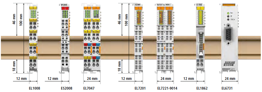

Housing
Fig.10: Terminal housing EtherCAT Terminals
Housing example | Name | Dimensions W x H x D | Wiring |
EL1008 | terminal housing | approx. 12 mm x 100 mm x 70 mm | screwless spring-loaded system |
ES2008 | terminal housing with pluggable wiring | approx. 12 mm x 100 mm x 70 mm | screwless spring-loaded system |
EL7047 | terminal housing, double width | approx. 24 mm x 100 mm x 70 mm | screwless spring-loaded system |
EL7201 | HD housing | approx. 12 mm x 100 mm x 70 mm | tool-free spring-loaded terminals |
EL7221‑9014 | HD housing, double width | approx. 24 mm x 100 mm x 70 mm | tool-free spring-loaded terminals |
EL1862 | HD housing with pin strip | approx. 12 mm x 100 mm x 70 mm | pin strip |
EL6731 | KM housing | approx. 24 mm x 100 mm x 52 mm | various connectors |
ELM3544 | ELM housing | approx. 30 mm x 100 mm x 95 mm | cage clamp, push-in |
For details on wiring, see chapter Mounting and wiring
