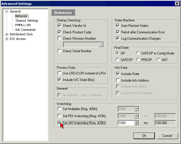

Fig.356: eEtherCAT tab -> Advanced Settings -> Behavior -> Watchdog Notes:
- the Multiplier Register 400h (hexadecimal, i. e. 0x0400) is valid for both watchdogs.
- each watchdog has its own timer setting 410h or 420h, which together with the Multiplier results in a resulting time.
- important: the Multiplier/Timer setting is only loaded into the slave at EtherCAT startup if the checkbox in front of it is activated.
- if it is not checked, nothing is downloaded and the setting located in the ESC remains unchanged.
- the downloaded values can be seen in the ESC registers 400h, 410h and 420h: ESC Access -> Memory

Watchdog time = [1/25 MHz * (Watchdog multiplier + 2)] * SM/PDI watchdog
Example: default setting Multiplier = 2498, SM watchdog = 1000 => 100 ms
The value in “Watchdog multiplier + 2” in the formula above corresponds to the number of 40ns base ticks representing one watchdog tick.
