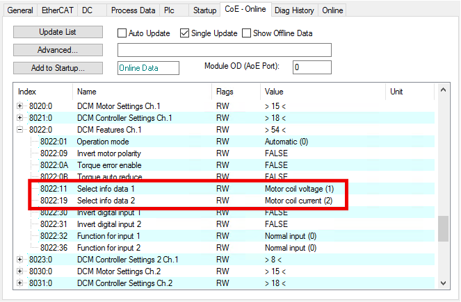

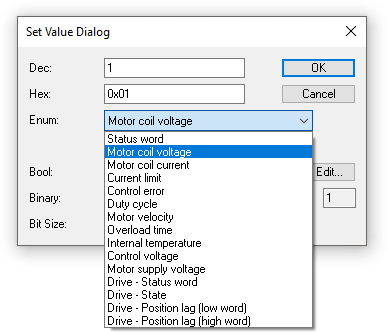

There is a possibility in the index 0x8022:11 "Select info data 1" and 0x8022:19 "Select info data 2", to select two parameters that can be displayed in the process data (see fig. Selection of additional information data).
These two parameters must be activated in the process data afterwards.
