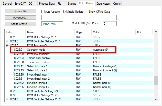

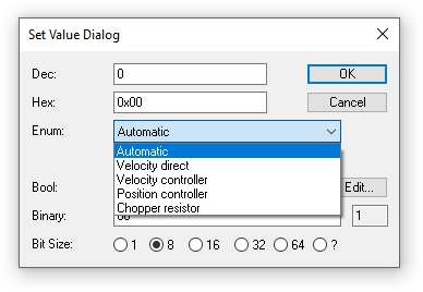

Selection of the operating mode
You can select the operating mode in the index 0x8022:01 "Operation mode". It is recommended that you select the operation mode "Automatic" (Fig. Setting the operation mode) and then set the suitable operation mode for your application on the Process Data tab. Further information on this can be found in the chapter "Process Data".
