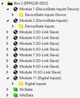

Process image
| Diagnostics. See chapter Further error diagnosis. | |
| Status variables of the IO-Link ports. See chapter Status of the IO-Link ports. | |
| Process data of the IO-Link device at port X01 | |
| Process data of the IO-Link device at port X02 | |
| Process data of the IO-Link device at port X03 | |
| Process data of the IO-Link device at port X04 | |
| Process data of the IO-Link device at port X05 | |
| Process data of the IO-Link device at port X06 | |
| Process data of the IO-Link device at port X07 | |
| Process data of the IO-Link device at port X08 | |
| Digital inputs. | |
1) The modules "Module 3" to "Module 10" only exist in the process data if the corresponding IO-Link ports have been configured.
