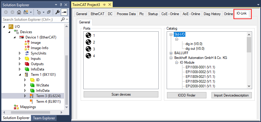

Open the IO link configuration tool
Requirement: an IO-Link master has been added in the Solution Explorer under the "I/O" entry.
1. Double-click on the IO-Link master.
A device editor for the IO-Link master opens.
2. Click on the "IO-Link" tab.
The IO-Link configuration tool opens. The configuration tool contains two fields:
Open the IO link configuration tool 1:Fig.9: IO-Link configuration tool
