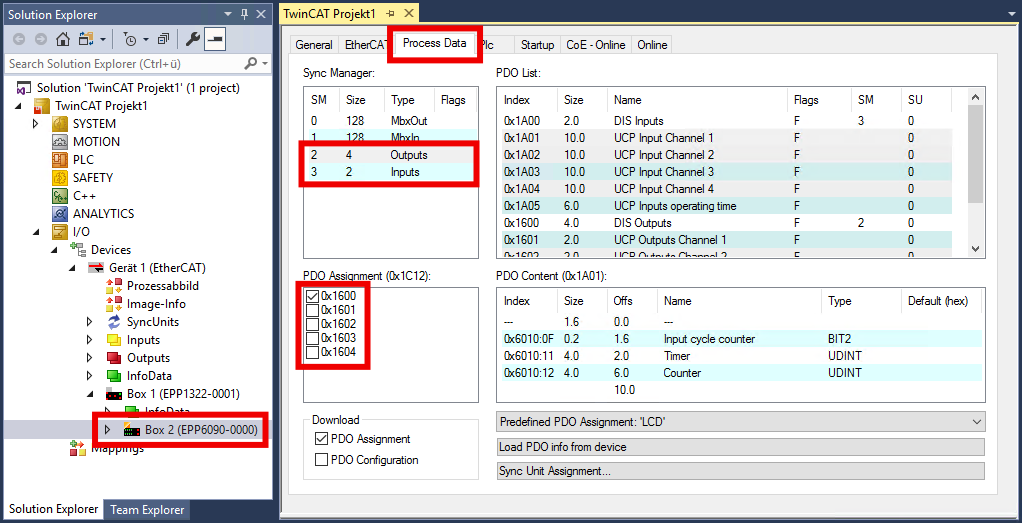

Configuring the process image
In the factory settings, only the process data objects for the following functions are enabled in the process image:
- Display
- Navigation switch
If you need further functions for your application, enable the corresponding process data objects:
- 1. Double-click EPP6090-0000 in the "Solution Explorer".
- 2. Click on the "Process Data" tab.
- 3. In the "Sync Manager" box, click "Outputs".
- 4. In the "PDO Assignment" box, check the checkboxes next to all required process data objects 0x16… .
See table below, "Outputs" column. - 5. In the "Sync Manager" box, click "Inputs"
- 6. In the "PDO Assignment" box, check the checkboxes next to all required process data objects 0x1A… .
See table below, "Inputs" column.
Function | Required process data objects | |||
Outputs | Inputs | |||
Display | 0x1600 | - | - | |
Navigation switch | - | - | 0x1A00 | |
Operating hour counter | - | - | 0x1A05 | |
Timer 1, Counter 1 | 0x1601 | 0x1A01 | ||
Timer 2, Counter 2 | 0x1602 | 0x1A02 | ||
Timer 3, Counter 3 | 0x1603 | 0x1A03 | ||
Timer 4, Counter 4 | 0x1604 | 0x1A04 | ||
