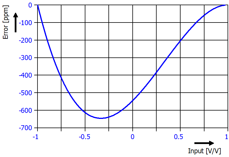

The specification and the manufacturer's calibration were determined with a 5 kΩ potentiometer. If a different potentiometer resistance is used, the measurements will be incorrect due to the changed parallel circuit ratios, see "Supply, potential groups" chapter.
Potentiometer measurement 1:
The distortion can also be recorded mathematically:
Potentiometer measurement 2:Fig.14: difference between 500 Ω and 5 kΩ potentiometer
Potentiometer measurement 3:

The following example code can be used to theoretically correct a different potentiometer:
    R_Poti_calibration : LREAL := 5000.0; // Ohm (vendor calibration case)
    R_Poti_actual : LREAL := 500.0; // Ohm (user application case)
    Rin : LREAL := 2.06E6; // Ohm
    PDO : LREAL; // RAW Value
    PDO_Ratio : LREAL;
    R2_act : LREAL;
    R1_act : LREAL;
    R2_act_Rin_parallel : LREAL;
    R2_calibration : LREAL;
    R1_calibration : LREAL;
    R2_calibration_Rin_parallel : LREAL;
    PDO_corrected : LREAL;
PDO_Ratio := PDO / 7812500.0;
R2_act := R_Poti_actual / 2.0 - PDO_Ratio * R_Poti_actual / 2.0;
R1_act := R_Poti_actual / 2.0 + PDO_Ratio * R_Poti_actual / 2.0;
IF (R2_act + Rin) <> 0 THEN
            R2_act_Rin_parallel := (R2_act * Rin) / (R2_act + Rin);
ELSE
            R2_act_Rin_parallel := 0.0;
END_IF
R2_calibration := R_Poti_calibration / 2.0 - PDO_Ratio * R_Poti_calibration / 2.0;
R1_calibration := R_Poti_calibration / 2.0 + PDO_Ratio * R_Poti_calibration / 2.0;
IF (R2_calibration + Rin) <> 0 THEN
            R2_calibration_Rin_parallel := (R2_calibration * Rin) / (R2_calibration + Rin);
ELSE
            R2_calibration_Rin_parallel := 0.0;
END_IF
IF (R1_act + R2_act_Rin_parallel) <> 0 AND R_Poti_actual <> 0 AND (R1_calibration + R2_calibration_Rin_parallel) <> 0 AND R_Poti_calibration <> 0 THEN
            PDO_corrected := (PDO_Ratio-
                        (((2.0*(0.5-R2_act_Rin_parallel/(R1_act+R2_act_Rin_parallel)))-
                        (2.0*(0.5-R2_act/R_Poti_actual)))-
                        ((2.0*(0.5-R2_calibration_Rin_parallel/(R1_calibration+R2_calibration_Rin_parallel)))-
                        (2.0*(0.5-R2_calibration/R_Poti_calibration)))))*7812500.0;
ELSE
            PDO_corrected := 0.0;
END_IF
