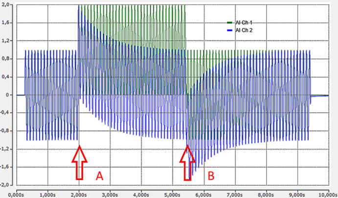

Example: A 10 Hz, ±1 V sine wave is applied simultaneously to Ch1 + Ch2 of an EL4374 using a signal generator.
Setting: Ch1 without filter treatment, Ch2 with filter 2 Settings = “HP 1 Hz”. With (A) an electrical offset of +1 V is added, the filter eliminates this within approx. 3 s. With (B) the electrical offset is removed again.
