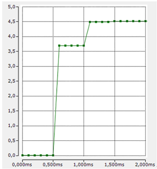

Filter 1 (low-pass) 2:
Fig.6: Example square wave signal 0->4.52 V on channel 1, filter disabled, EtherCAT cycle time 100 µs

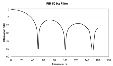

Filter 1 (low-pass) 3:
Fig.7: FIR 50 Hz filter

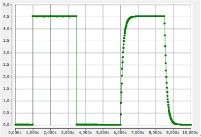

Filter 1 (low-pass) 4:
Fig.8: Comparison of square wave signal 0.2 Hz/4.5 V, EtherCAT cycle time 100 µs, left filter disabled, right IIR8
