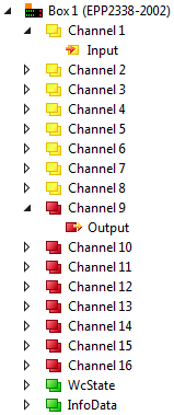

Process image
Process image in TwinCAT
Connector
Contact
Input variable
Output variable
Process image 1:
X01
2
Process image 2: Channel 2
Process image 3: Input
Process image 4: Channel 10
Process image 5: Output
4
Process image 6: Channel 1
Process image 7: Input
Process image 8: Channel 9
Process image 9: Output
X02
2
Process image 10: Channel 4
Process image 11: Input
Process image 12: Channel 12
Process image 13: Output
4
Process image 14: Channel 3
Process image 15: Input
Process image 16: Channel 11
Process image 17: Output
X03
2
Process image 18: Channel 6
Process image 19: Input
Process image 20: Channel 14
Process image 21: Output
4
Process image 22: Channel 5
Process image 23: Input
Process image 24: Channel 13
Process image 25: Output
X04
2
Process image 26: Channel 8
Process image 27: Input
Process image 28: Channel 16
Process image 29: Output
4
Process image 30: Channel 7
Process image 31: Input
Process image 32: Channel 15
Process image 33: Output
