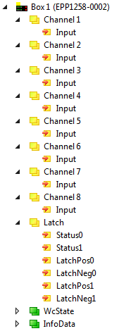

Process image
Process image in TwinCAT
Connector
Contact
Input variable
Process image 1:
X01 / X02
2
Process image 2: Channel 2
Process image 3: Input
Process image 4: Latch
Process image 5: Status1
Process image 6: LatchPos1
Process image 7: LatchNeg1
4
Process image 8: Channel 1
Process image 9: Input
Process image 10: Latch
Process image 11: Status0
Process image 12: LatchPos0
Process image 13: LatchNeg0
X03 / X04
2
Process image 14: Channel 4
Process image 15: Input
4
Process image 16: Channel 3
Process image 17: Input
X05 / X06
2
Process image 18: Channel 6
Process image 19: Input
4
Process image 20: Channel 5
Process image 21: Input
X07 / X08
2
Process image 22: Channel 8
Process image 23: Input
4
Process image 24: Channel 7
Process image 25: Input
Working Counter
The Working Counter is a diagnostic function for EtherCAT networks. A description of the Working Counter can be found in the EtherCAT system documentation.
