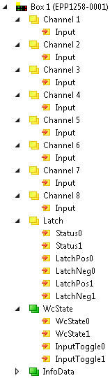

Process image
Process image in TwinCAT |
| Connector | Contact | Input variable |
| X01 | 4 |
X02 | 4 |
X03 | 4 |
X04 | 4 |
X05 | 4 |
X06 | 4 |
X07 | 4 |
X08 | 4 |
Working Counter
The Working Counter is a diagnostic function for EtherCAT networks. A description of the Working Counter can be found in the EtherCAT system documentation.
WcState0: Working Counter for the inputs Channel 3 to Channel 8
WcState1: Working Counter for the Timestamp inputs Channel 1 and Channel 2
Channel 1
Input
