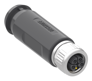

Supply voltage downstream connection
The supply voltages applied to the supply voltage input are available at the forwarding output for supplying other devices.
Notice | |
Risk of overload Excessive output currents from the forwarding output can cause the maximum permissible input current at the supply voltage input to be exceeded.
Forwarding: M12 female socket | Pin | Function | |
| 1 | +24 VDC US |
2 | GNDP | ||
3 | GNDS | ||
4 | +48 VDC UP | ||
5 | ⏚ | ||
