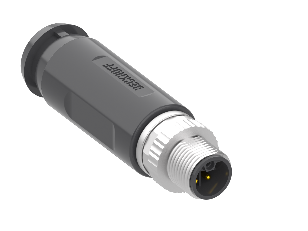

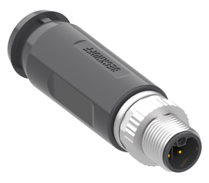

Supply voltage input 1:
M12 connector
Pin
Function
Supply voltage input 2:
1
+24 VDC US
2
GNDP
3
GNDS
4
+48 VDC UP
5
