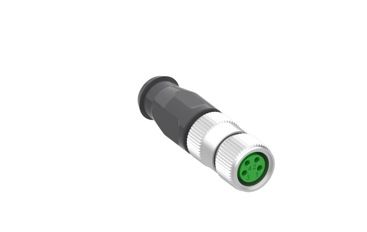

EtherCAT input
M8 coupling | Pin | Function |
1 | Tx+ | |
2 | Rx+ | |
3 | Rx- | |
4 | Tx- |

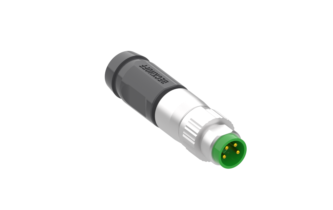

EtherCAT forwarding
M8 connector | Pin | Function |
1 | Tx+ | |
2 | Rx+ | |
3 | Rx- | |
4 | Tx- |
