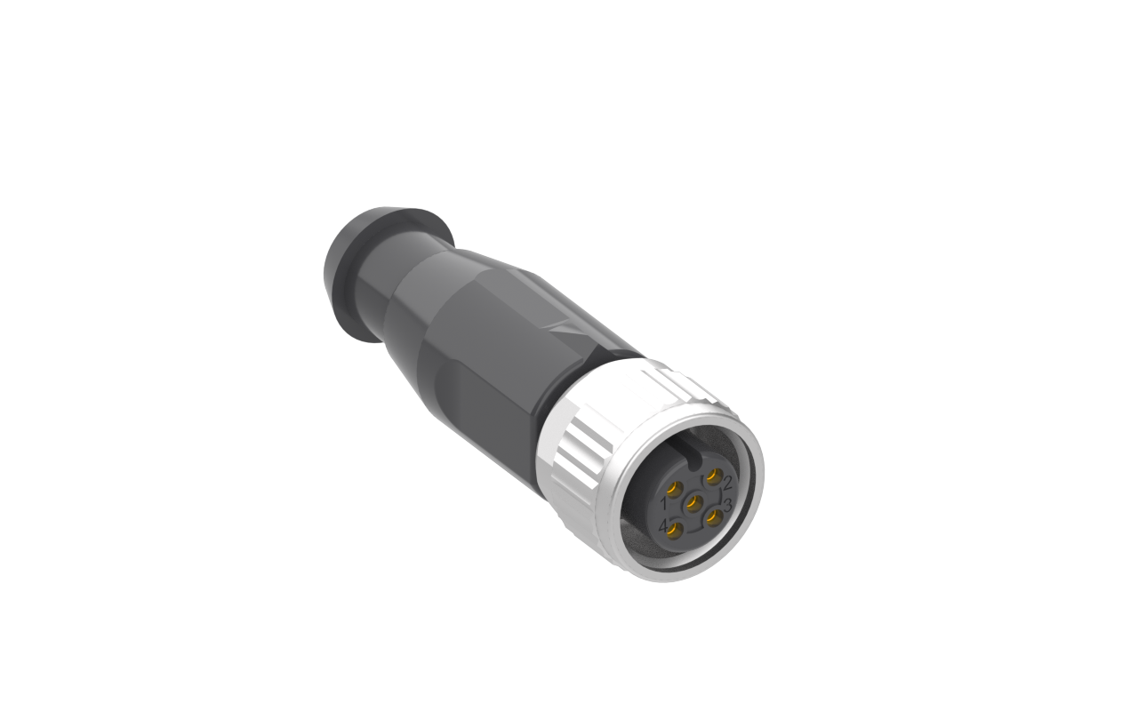

Digital I/O 1:
M12 coupling
Pin
Function
Digital I/O 2:
1
US = 24 VDC
2
Input/Output B
3
GNDS
4
Input/Output A
5
n.c.
