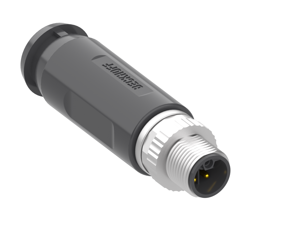

M12 connector | Pin | Function |
1 | +24 VDC US | |
2 | GNDP | |
3 | GNDS | |
4 | +48 VDC UP | |
5 | ⏚ |
