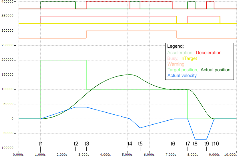

With overrun of the target position
Time
POS Outputs
POS Inputs
t1:
Execute = 1
Target position = 200000
Velocity = 5000
Start type = 0x0001
Acceleration = 3000
Deceleration = 5000
Busy = 1
Accelerate = 1
  • Specification of the 1st parameter
  • Start of the 1st acceleration phase
t2:
Accelerate = 0
  • End of the 1st acceleration phase
t3:
Target position = 100000
Velocity = 1500
Start type = 0x1001
Acceleration = 1000
Deceleration = 2000
Warning = 1
Decelerate = 1
  • Change of the parameters
  • Activation by new start types
  • Warning of overrunning the target position
  • Start of the 1st deceleration phase
t4:
Accelerate = 1
Decelerate = 0
  • End of the 1st deceleration phase
  • Start of the 2nd acceleration phase in the opposite direction
t5:
Accelerate = 0
Decelerate = 1
  • End of the 2nd acceleration phase
  • Start of the 2nd deceleration phase
t6:
Execute = 0
Busy = 0
In-Target = 1
Decelerate = 0
  • End of the 2nd deceleration phase
  • Motor is at the new target position
t7 - t10:
  • Absolute travel back to the start position 0
Examples of two travel commands with a dynamic change of the target position 2:Fig.22: Scope recording with overrunning of the final target position
The axis scaling refers only to the positions, not to the speed or the status bits.
