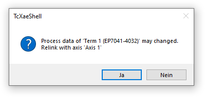

- A dialog box appears:
- 4. Confirm with "Yes".
