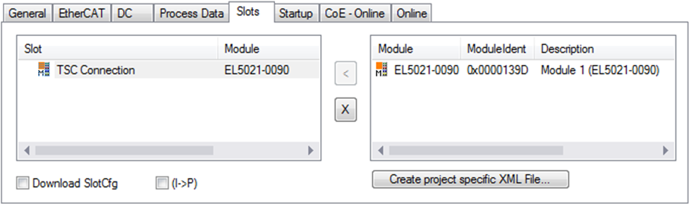

By default the TwinSAFE SC communication channel of the respective TwinSAFE SC component is not enabled. In order to be able to use the data transfer, the corresponding TwinSAFE SC module must first be added under the Slots tab. Only then is it possible to link to a corresponding alias device.
Fig.44: Adding the TwinSAFE SC process data under the component, e.g. EL5021-0090Additional process data with the ID TSC Inputs, TSC Outputs are generated (TSC - TwinSAFE Single Channel).

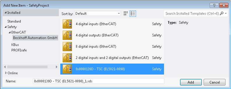

Fig.45: TwinSAFE SC component process data, example EL5021-0090A TwinSAFE SC connection is added by adding an alias devices in the safety project and selecting TSC (TwinSAFE Single Channel)
Fig.46: Adding a TwinSAFE SC connectionAfter opening the alias device by double-clicking, select the Link button

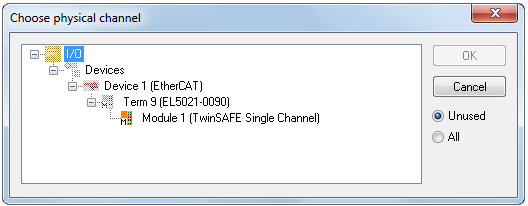

next to Physical Device, in order to create the link to a TwinSAFE SC terminal. Only suitable TwinSAFE SC terminals are offered in the selection dialog.

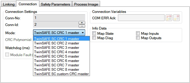

Fig.47: Creating a link to TwinSAFE SC terminalThe CRC to be used can be selected or a free CRC can be entered under the Connection tab of the alias device.

Fig.48: Selecting a free CRCThese settings must match the settings in the CoE objects of the TwinSAFE SC component.

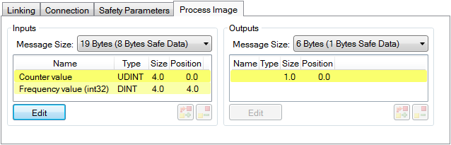

The TwinSAFE SC component initially makes all available process data available. The Safety Parameters tab typically contains no parameters. The process data size and the process data themselves can be selected under the Process Image tab.

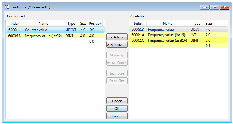

Fig.49: Selecting the process data size and the process dataThe process data (defined in the ESI file) can be adjusted to user requirements by selecting the Edit button in the dialog Configure I/O element(s).
