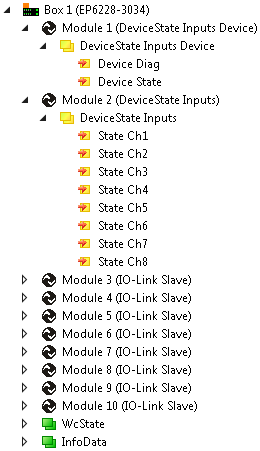

Process image
| Diagnostics. See chapter Further error diagnosis. | |
| Status bytes of the IO-Link ports. See chapter Status of the IO-Link ports. | |
| Process data of the IO-Link device at port 1 | |
| Process data of the IO-Link device at port 2 | |
| Process data of the IO-Link device at port 3 | |
| Process data of the IO-Link device at port 4 | |
| Process data of the IO-Link device at port 5 | |
| Process data of the IO-Link device at port 6 | |
| Process data of the IO-Link device at port 7 | |
| Process data of the IO-Link device at port 8 | |
1) The modules "Module 3" to "Module 10" only exist in the process data if the corresponding IO-Link ports have been configured.
Assignment of connectors, ports and process data
Connector | IO-Link port | Process data | Status variable |
X01 | 1 |
X02 | 2 |
X03 | 3 |
X04 | 4 |
X05 | 5 |
X06 | 6 |
X07 | 7 |
X08 | 8 |
