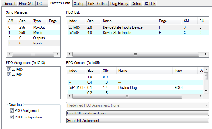

PDO Assignment
The scope of the process data offered varies depending on the configured IO-Link ports.
DeviceState Inputs Device and DeviceState Inputs are selected by default. Device-specific PDOs (0x1A0n Port (n-1) Process Data) are only displayed after configuring on the respective port and restarting the EtherCAT system or reloading the configuration in Config mode (F4); see Configuration of the IO-Link master.
PDO Assignment 1:Fig.40: Illustration of the EP6224-2022 process data allocation, SM3 inputs
SM3, PDO Assignment 0x1C13
