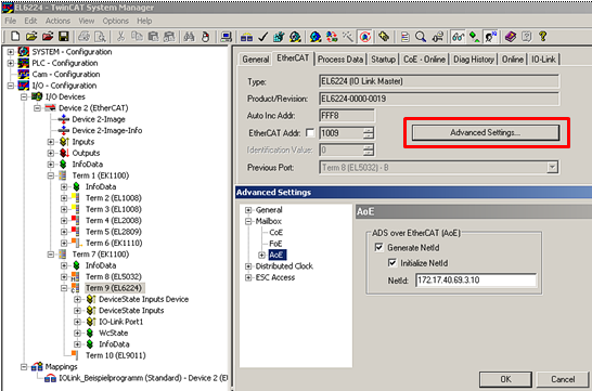

AoE NetID
The EP622x is assigned a dedicated AoE-NetID for communication with the IO-Link master section. This is assigned by the configuration tool (Fig. Assignment AoE-NetID).
NetID at EP622x -> "EtherCAT"-> "Advanced Settings" -> "Mailbox" -> "AoE"
Fig.41: AoE-NetID allocationPortNo
