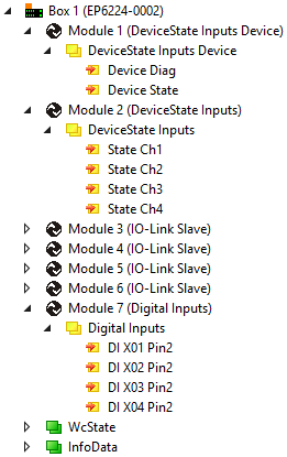

Process image
Process image 1:
Process image 2: Module 1
Diagnosis.
See chapter Further error diagnosis.
Process image 3: Module 2
Status variables of the IO-Link ports.
See chapter Status of the IO-Link ports.
Process image 4: Module 3 1)
Process data of the IO-Link device at port X01
Process image 5: Module 4 1)
Process data of the IO-Link device at port  X02
Process image 6: Module 5 1)
Process data of the IO-Link device at port X03
Process image 7: Module 6 1)
Process data of the IO-Link device at port X04
Process image 8: Module 7
Digital inputs.
1) The modules "Module 3" to "Module 6" only exist in the process data if the corresponding IO-Link ports have been configured.
