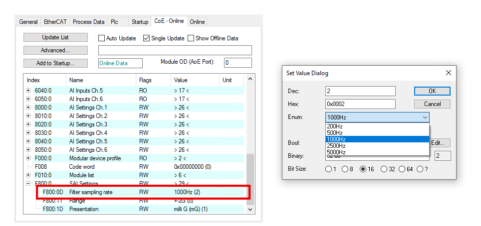

Setting of the internal sampling rate via index 0xF800:0D
Fig.6: Setting of the internal sampling rate (index 0xF8000:0D)The internal sampling rate with filters switched on is set via the index 0xF800:0D. On delivery this is set to 1000 Hz.
![]() | Changing the update rate at 2000 Hz and 5000 Hz The resolution is reduced to 8-bit if the rate is increased to 2500 Hz or 5000 Hz. This is necessary due to the sensors used. |
