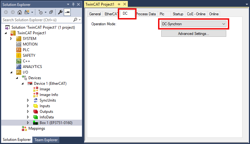

- 1. On the “DC” tab, select the “DC-Synchron” option in the “Operation Mode” list box.
- 2. Activate the configuration.
