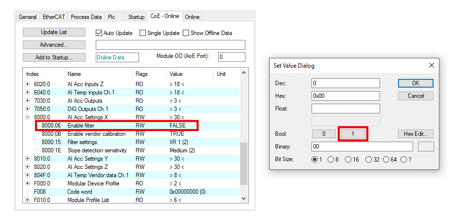

Measured value jumps when enabling or disabling a filter
When a filter is enabled or disabled, short-term measured value jumps can occur in the process data that do not correspond to the physical values.
Set parameter 80n0:0:06 "Enable filter" to TRUE, to enable a filter.
Example for the x-axis:
Enable 1:
