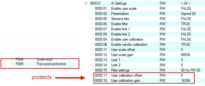

Password protection for user data
Some user data are protected against unwanted or inadvertent writing by an additional password to be entered in CoE 0xF009:
Measured value processing 2:Fig.12: Password protection for the 0x8000:17 and 0x8000:18 entries (example)
Use of CoE 0xF009
Password protection takes effect with the following AI settings:
