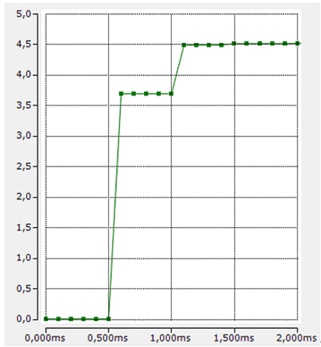

- Filter activation: CoE Index 0x80n0:06
The filter is enabled by default in this analog channel, see below for properties. Channel properties with disabled filter:
Conversion time | Sampling rate |
500 µs | 2000 sps |
Fig.9: Example square wave signal 0->4.52 V on channel 1, filter disabled, EtherCAT cycle time 100 µs- Filter type: CoE Index 0x80n0:15

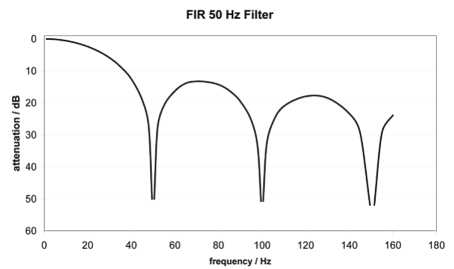

- FIR filter
The filter performs a notch filter function and determines the conversion time of the terminal. The higher the filter frequency, the faster the conversion time. A 50 Hz and a 60 Hz filter are available. Notch filter means that the filter has zeros (notches) in the frequency response at the filter frequency and multiples thereof, i.e. it attenuates the amplitude at these frequencies. The FIR filter operates as a non‑recursive filter.
Fig.10: FIR 50 Hz filter Filter data FIR:
Filter | Attenuation | Cut-off frequency (-3 dB) | Conversion time | Sampling rate |
50 Hz FIR | >50 dB | 22 Hz | 625 µs | 1600 sps |
60 Hz FIR | >45 dB | 26 Hz | 521 µs | 1920 sps |

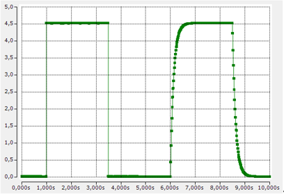

- IIR filter
The filter with IIR characteristic is a time-discrete, linear, time-invariant 1st order low-pass filter (-20 dB/decade), which can be set in 8 levels, i.e. cut-off frequencies (level 1 = weak recursive filter, up to level 8 = strong recursive filter) The IIR can be understood to be a sliding average value calculation after a low-pass filter.
IIR filter | Cut-off frequency (-3 dB) |
IIR 1 | 1 kHz |
IIR 2 | 500 Hz |
IIR 3 | 285 Hz |
IIR 4 | 142 Hz |
IIR 5 | 66 Hz |
IIR 6 | 33 Hz |
IIR 7 | 17 Hz |
IIR 8 | 8.2 Hz |
Fig.11: Comparison of square wave signal 0.2 Hz/4.5 V, EtherCAT cycle time 100 µs, left filter disabled, right IIR8
