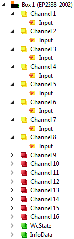

DI Inputs
You can find the digital inputs at "Channel 1" to "Channel 8".

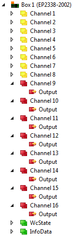

DO Outputs
You can find the digital outputs at "Channel 1" to "Channel 8".
