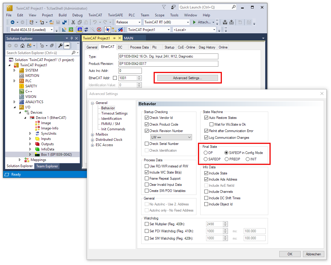

You can set the box to automatically switch to "Operational" state in Config Mode:
1. Click on the box in Solution Explorer.
2. Open the EtherCAT tab.
3. Click the Advanced Settings … button.
4. In the Final State field, select the OP option.
5. Confirm with OK.
