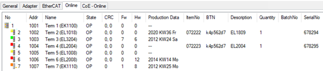

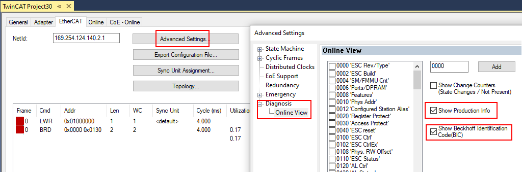

 - From TwinCAT 3.1 build 4024.11, the eBIC can be displayed in the online view.
 - To do this, check the "Show Beckhoff Identification Code (BIC)" checkbox under
EtherCAT → Advanced Settings → Diagnostics:
 - The BTN and its contents are then displayed:
 - Note: As shown in the figure, the production data HW version, FW version, and production date, which have been programmed since 2012, can also be displayed with "Show production info".

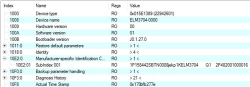

 - EtherCAT devices with a CoE directory may also have the object 0x10E2:01 to display their own eBIC, which can also be easily accessed by the PLC:
 - The device must be in PREOP/SAFEOP/OP for access:
 - The object 0x10E2 will be preferentially introduced into stock products in the course of necessary firmware revision.
 - From TwinCAT 3.1. build 4024.24, the functions FB_EcCoEReadBIC and FB_EcCoEReadBTN for reading into the PLC are available in the Tc2_EtherCAT library from v3.3.19.0
