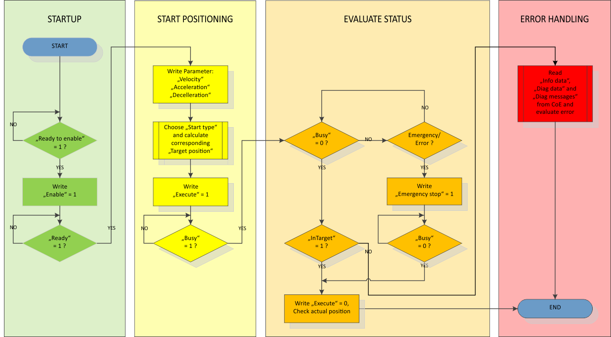

It is also possible to start travel commands without the function blocks of the library "Tc3_DriveMotionControl". This is based on the following state machine:
State machine 1:

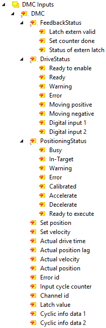

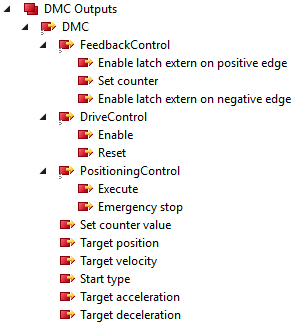

The variables for control and evaluation are located in the process data objects "DMC Inputs" and "DMC Outputs":
State machine 2:
State machine 3:
