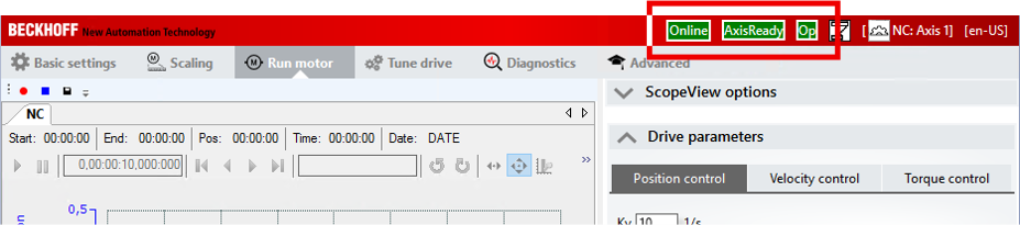

The axis only executes motion commands when it is enabled. Enable the axis as follows:
1. Check whether the icons "Online", "AxisReady" and "Op" are in the title bar of Drive Manager 2 and whether they are highlighted in green
Axis enable 1:
If yes: the Drive Manager 2 is ready.

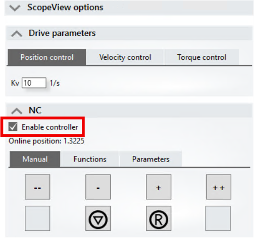

2. On the right side under "NC" activate the checkbox "Enable controller"
Axis enable 2:
The axis is enabled.
At the housing of the ELM72xx the LED "OK" next to X002 is green.
