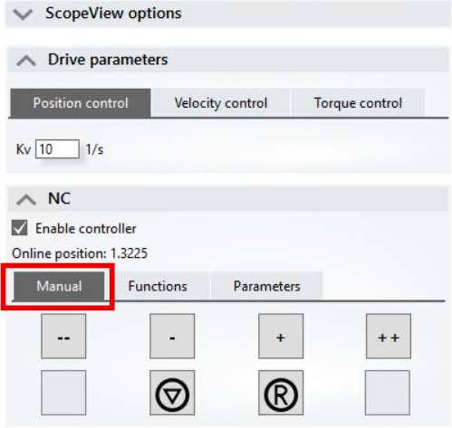

You can move the motor as you wish in manual mode.
The controls for manual operation are located on the right side of the window under "NC" > "Manual".
Manual operation 1:
The following buttons are available:
Button
Explanation
Travel in the negative direction at 5% of the maximum velocity.
Travel in the negative direction at 30% of the maximum velocity.
Travel in the positive direction at 5% of the maximum velocity.
Travel in the positive direction at 30% of the maximum velocity.
Manual operation 2:
Stop the NC axis
R
Reset an error from the Motion NC
The motor only runs as long as a button is pressed. As soon as you release the mouse button, the motor stops.
Manual operation 3:
Behavior in case of an error
If an error occurs, the following symbol appears in the user interface:
Manual operation 4:
  • Move the mouse cursor over the symbol to get more information about the error.
  • Click the "R" button to acknowledge all errors.
    If the error cannot be acknowledged, check the messages in the tab "Diagnostics".
